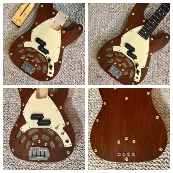

I have been working on a number of guitar-centric projects, but not a lot that was build related. That said, I just completed a conversion neck and string-through bridge install on a Lindert replica P body. The history of this bass is documented here.
https://www.talkbass.com/threads/geos-bass-body-weight-reduction-program.1358552/
This was a fun project to take on, and I had a great time adding my own touch to this collaboration.
You have to love the benefits of standardization. This particular neck already had threaded inserts installed, so I was a little concerned I might need to plug and re-drill the neck mounting holes to get everything to line up. Note the locating pins in the first frame. I needed to widen the pocket about 0.08", but once I did that everything fit together perfectly.
I have installed string-through ferrules in finished bodies more than a dozen times, and it's always a little nerve-wracking. The proof is in the pudding, I guess.
The new bridge was installed using three of the original mounting holes. The rest are covered by the plate and are not visible. If we chose not to add the string-through ferrules, this would have been a 100% reversible modification.
Here she is, fully assembled.

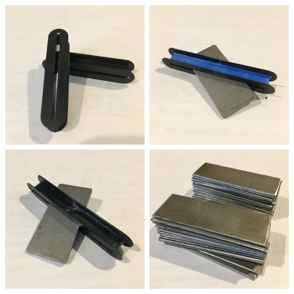

A few years back, I worked with Lindy Fralin on a prototype of the pickup that ultimately became the Fralin Big Single, and that's what I used in the first Ridler bass.
It's a sidewinder-style pickup that has the bobbins aligned horizontally and a steel blade that runs through the center. A bar magnet rests on the blade in-between the two bobbins and acts as a narrow sensing aperture, like a single-coil, but with hum canceling properties.
I have always wanted to offer this pickup in five string format, but struggled with how to fabricate the bobbins. After spit-balling one Friday afternoon with Lindy first, then Dan Rocha later on, we had an Occam's razor event. Why not just cut the ends off two Fralin bobbins and glue them together to make one longer one?
With a razor saw, some blue tape, a blade for a jig, and some CA adhesive, I now have a bobbin that will work for string spacing up to 3". I went to the local Metal Supermarket and had 30 blades cut for $20, and we're ready to fabricate.
