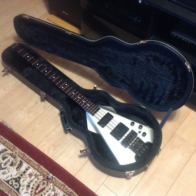

Wow, 7 years! Jumping ahead to the present - I gave this bass to a neighbor who is an older (70-ish) gentleman who works on and customizes guitars and electronic gear. He's actually a fretless guitar player and puts mirrored glass fingerboards on his guitars! Anyway, it was a low priority thing for him, and it was in his hands for over a year and 8 months. It finally came home on Tuesday in completely playable condition. Ran it through a 2 hour set with a band I'm doing some summer shows with last night. Stays in tune, etc. VERY long story short - the wood was compressing behind the backing plate for the truss rod nut. As that plate sank in, it was forcing the wood to split. I'd had the split fixed once by someone else, but it came back fairly quickly. Jack fixed the split, and used some kind of metal-impregnated epoxy to fill the compromised area. Rod is perfectly functional now, and action is where it should be. Couple of pics below...
