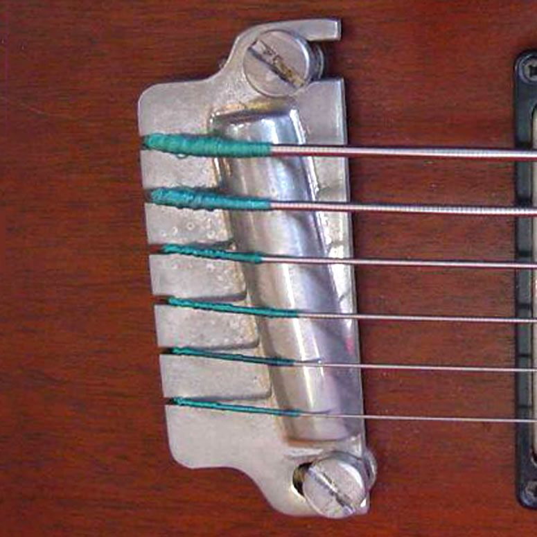

Scale is the same too, bridge positioning as well, number of frets dito, bridge is different though (pic stolen from Jules' Fly Guitar site).

Is that a six string flatwound set i see on that bridge? I´m looking forward to meeting people whom which I can talk

I've played both, and had the opportunity to buy several. After owning a Fender Bass VI, I couldn't bring myself to pay over $1k, but less than $2k, for one, which is what they all seemed to be going for. I preferred the ES to the SG body as it hung on me better.  They all came with flats - no roundwound 6 strings until years later.  So, building one out of a junked EB-0 sounds like fun.  I have thought of it myself in the past, since so many have cracked headstocks. Might as well make it longer.
The old bridge isn't really different than the 4 string either - just notched differently.  Same size. Nice and crowded.

If you work with semblances of the original bridge on your project, remember you will need a 6 string bass set with guitar size small ballends! Bass size ballends will be too big, not allow the bridge to be lowered enough and gnaw into the surface of the bass.
I've been there.  :-\

I spent quite some time looking, dear Dave! Fender 6 strings have thick ball ends (no one told me!) and they also have the manliest gauge: 025, 035, 045, 055, 075 and 095 (the gauges aren't an issue, the ballends are!). Unusable on the original EB-6 bar bridges, but if you used a Schaller six string roller bridge you might do fine even though I would imagine the thicker ballends sticking out from the guitar ballend size cavities. But beauty is only fin-deep as they say.
