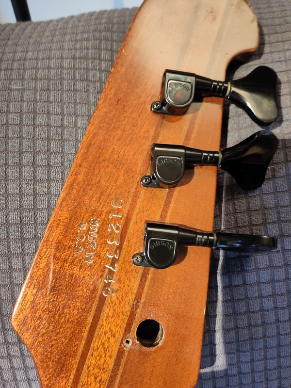

so my Krugerands into Gibson mission has struck the rocks.
I bought a 93 thunderbird from Reverb, when I got it and tuned it to pitch there was a horrible rattling when playing the open E and A. I took it to my local guitar tech to check out to see if it just needed a setup or  I had bought a lemon.
The results are not good.
 He got the buzzing to go away with a truss rod adjustment, but a twist in the neck means the G is always going to have a reasonably high action (TBH i could live with this, I played it like it and it didn't seem all that high)
But worse when he was putting new strings on it the E tuner cog is broken.
I dont know whether to at this point engage with Reverb to get my money back  or keep it and ask for the price of a new machine head to be refunded?
my guy says that to replace it with a non Gibson part will require a larger hole to be reamed which will obviously affect the value. how likely am I to be able to find a replacement?
 what do I do ?

There should be no reaming required to replace the tuner. It's likely a Schaller M4 or Gotoh GB7, possibly stamped "GIBSON" on the back. I've got a set of (4) black Schallers that say Gibson that I've been thinking of selling, but they are for a 2+2 headstock (came off my Les Paul).
unfortunately its neither a schaller or a Gotoh, both of those have a 14mm bore and the bass has a 13mm hole.
also the ears for the screws are in a totally different place
where are the ears on the gibson ones your thinking of selling and what is the bore size?

For what it's worth, those look exactly like the tuners from my LPB1 of similar age. Per Rob's bass book they are "Gibson-branded Schaller".
I think Gearhed is right and they are Schaller M4.
Unfortunately, based on a little searching, I've seen brand new tuners called "Schaller M4" as well as vintage ones going back at least to the 70s, and the current ones look very different.  It's also confusing because there are various suffixes meaning I don't know what, but the M4S is completely different.
This one from about 1990 looks right to me, but chrome:
https://reverb.com/item/78037879-schaller-bass-tuner-m-4l-in-line-1990-chrome
This one purportedly from the 1970s looks similar, but the post is a little different. https://reverb.com/item/70648599-bass-side-schaller-m4-bass-tuner-1970-s-gold-m4g-original-vintage

Those are Schaller M4, exactly like the ones I have. Hamer used them too with the Hamer logo stamped on the back. Schaller often put guitar manufacturer names on their bridges too.
