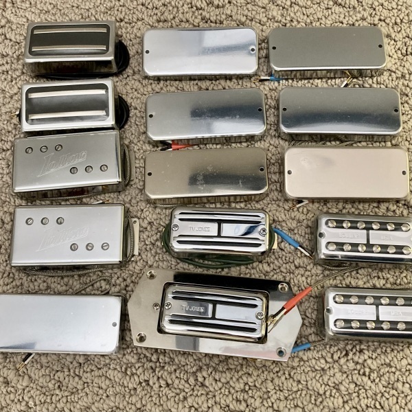

I spent today setting up pickups with quick connects. Lots of stuff in the pipeline.

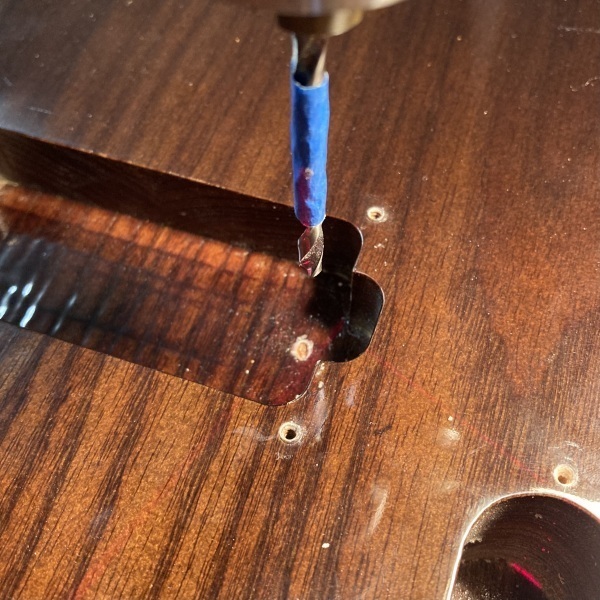

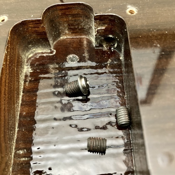

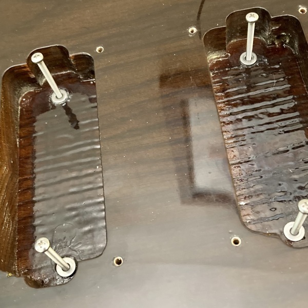

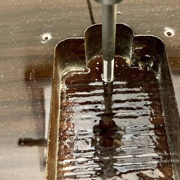

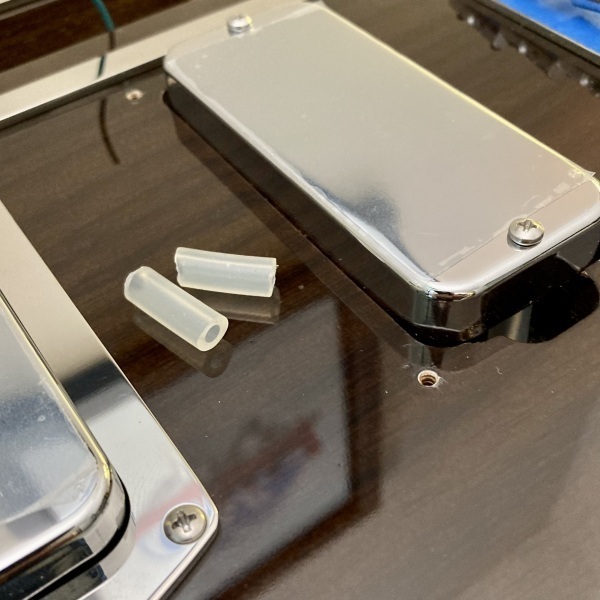

On the build front, I use EZ Lok 329-004 inserts to mount Thunderbird pickups. I drill and tap them like my neck inserts, I use a 4-40 screw and washer to set the depth into the body, and then I glue the washer in place. This ensures that all of the compression force from the surgical tubing is exerted on the insert and there is no force actively pushing the pickup out of the body. It's a bit fussy, but I think it's worth it, especially because my plug-and-play pickup system encourages pickup swapping.

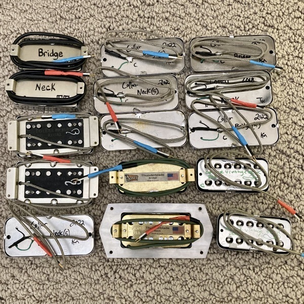

I use TE Connectivity gold-plated aircraft-grade connectors (204351-1 and 204370-2) crimped in place and color-coded with shrink-wrap. The resulting connector is nearly as slender as the wires alone and can be fished through typical pickup wire channels with no issues.
