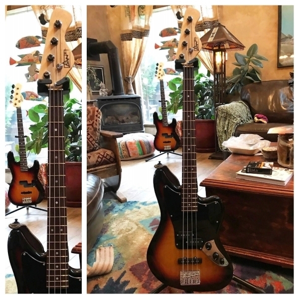

My top selling item is the 32" scale conversion neck.
It converts an American spec 34” long scale bass to 32” medium scale without modification.
I love getting photos of these necks after they have been installed.
Here are two basses by Todd M:

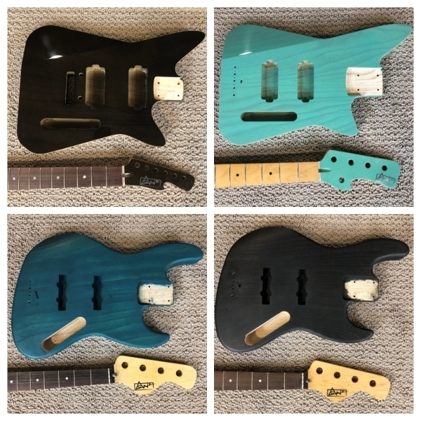

These four bodies will feature Rubio Monocoat finishes and 32" scale conversion necks:

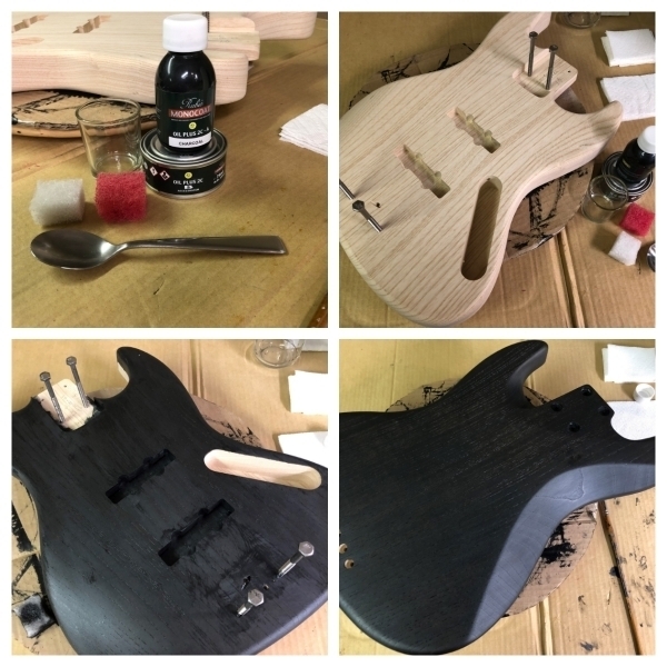

I'm loving this Rubio Monocoat finish.
I'd guess I used less than 20ml of material to finish this body.
One and done...amazing.
« Last Edit: May 04, 2019, 08:19:36 PM by BeeTL »

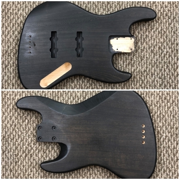

Here's the Charcoal body after curing about 12 hours:

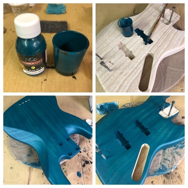

The next color up is Peacock Green.
I mixed three teaspoons of finish with one teaspoon of Part B accelerator and used an artist's bristle brush to apply the oil in the cavities.
For cleanup I used no more than 2 cut up paper towels and one ounce of mineral spirits.
Not bad.
« Last Edit: May 05, 2019, 02:32:11 PM by BeeTL »

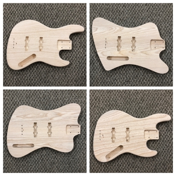

So, here are some of the pieces currently in the pipeline for Summer NAMM.
