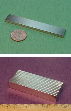

I'd lower the bridge pickup until it matches the neck pickup. I hate it when I flip the switch and the volume drops. If you want to raise the neck pickup, don't over-tighten the adjustment screws, over-tightening sometimes results in cracking the pickguard.
There's another neat trick that I learned from Ted Staberow. Get a neodymium magnet like this one and attach it to the back of the neck pickup. You will get an instant boost in the neck pickup's output.

Ilan, that's a great idea! I'll try that first and see what gives. If I can keep the original pup I'll do it, but as in the case of the bridge pup, I'll replace it if necessary.
