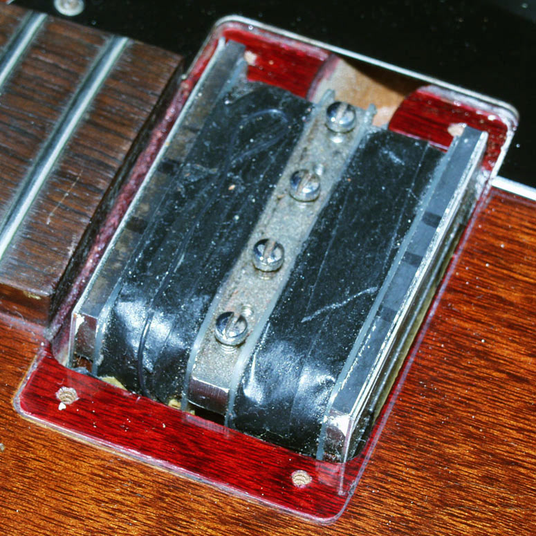

My first thought when Dave said the aluminum element would create a muddied sound was - why not replace it with steel? Kinda like one big blade.....
You can't put steel between the two blades because it will short out the magnetic circuit.  If you take a humbucker and place a piece of steel between the two sets of poles, you wont get any sound.
The original mudbucker had a single row of poles between the two sideways mounted coils. What Gibson could have done is what I did, and utilized the fake pole pieces. What they ended up making is more like a DiMarzio Model One, but with a row of phony poles.
Curtis Novak did a replacement like this:
This is better than the Gibson SG pickup because it doesn't have the aluminum block and the real poles are closer to the top of the cover.
Don't get me wrong though, I'm a fan of the real mudbuckers, for what they do.  I have one in one of my '73 Ricks. :)

Why are the real polepieces not aligned with the fake screws in the middle?
If the string spacing is matched to those fake screws you'd miss out a big part on the E and G string.
That's a good question!
If you look at the photo here:
http://curtisnovak.com/pickups/EB-AA.shtml
The strings are falling over the fake poles.    ???
  • Posts: 21519
Re: Mudbucker ...not
« Reply #20 on: December 19, 2011, 07:14:35 AM »
It works, Rob. I have it on my Epi Newport where a preowner slipped just one SD telecaster pup in slanted fashion underneath the chrome cover, no alignment with the cover screw holes, but all strings sound for whatever reason even.
